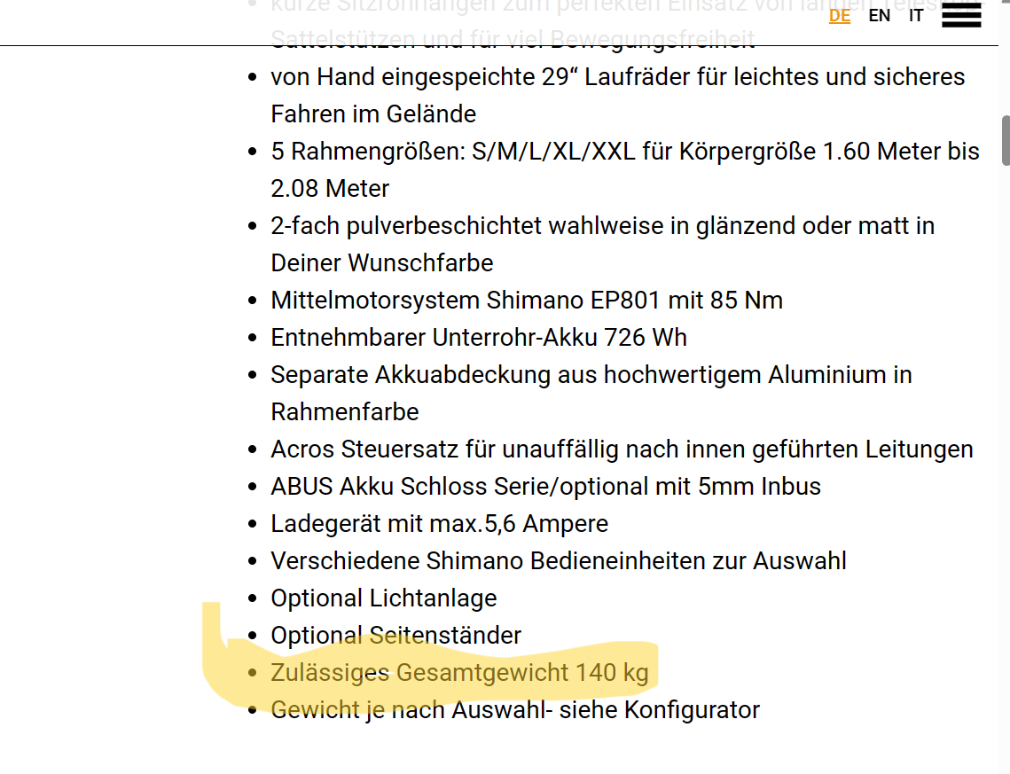

Maxx bikes in Rosenheim. Sind Hersteller.
https://www.maxx.de/de/bikes/e-mtb/fab4_els_x2/
