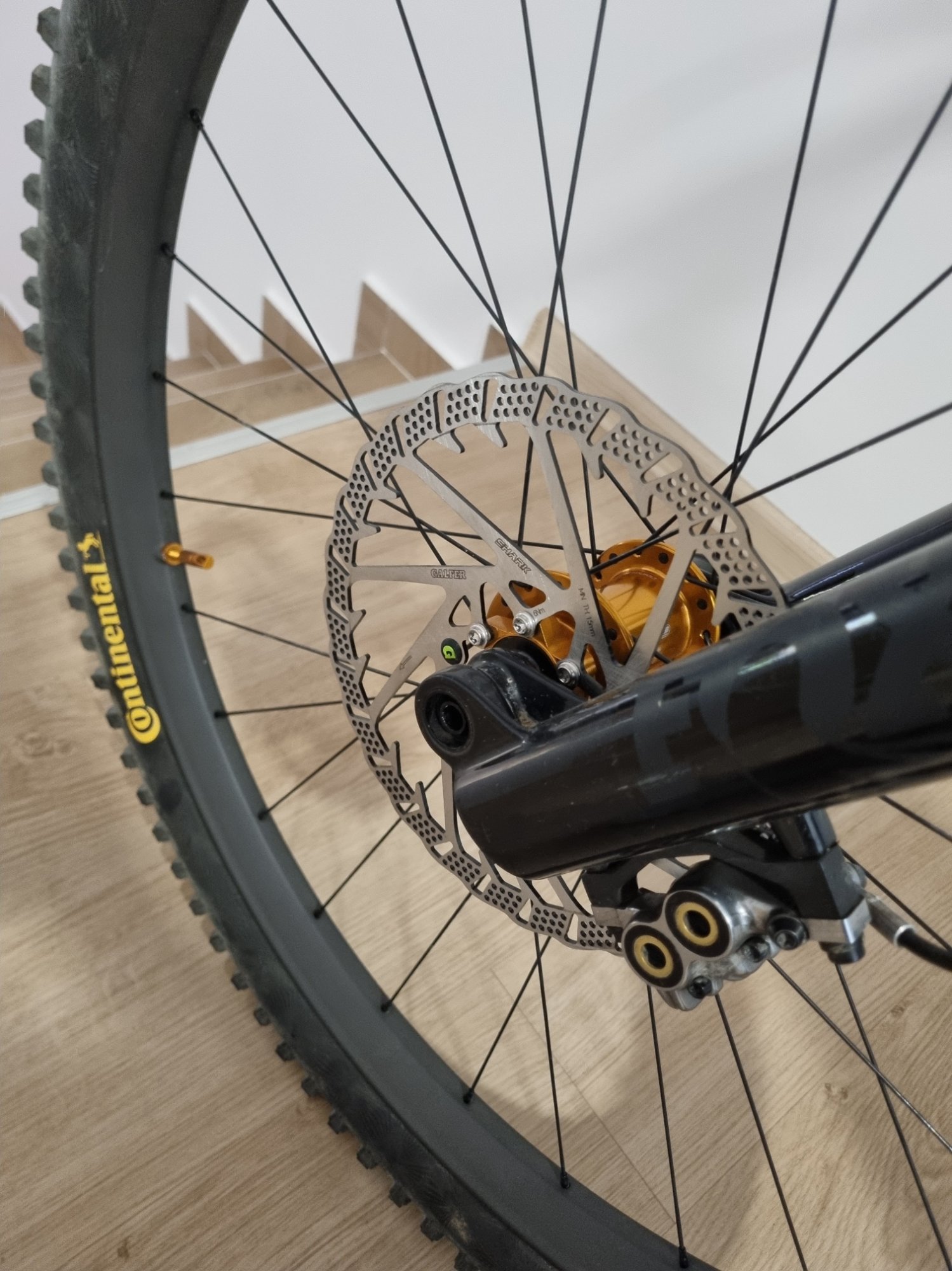

I can give you my experience in english, I've been using TRP R1 with Magura 8.R or Sinter Green pads on MT7 for a long time (5000km+-) and they been very good (no vibrations like Storm HC) with thickness still around 2,07mm, and also heat resistant, now I am using Galfer Shark with Sinter Green and they are even better (more bite because Sharks have more aggressive design which I like) So if you dont care about price Sharks, If you need something less expensive then TRP R1 or R05. TRP S05E 2,3mm has the best performance/thickness/price ratio.
