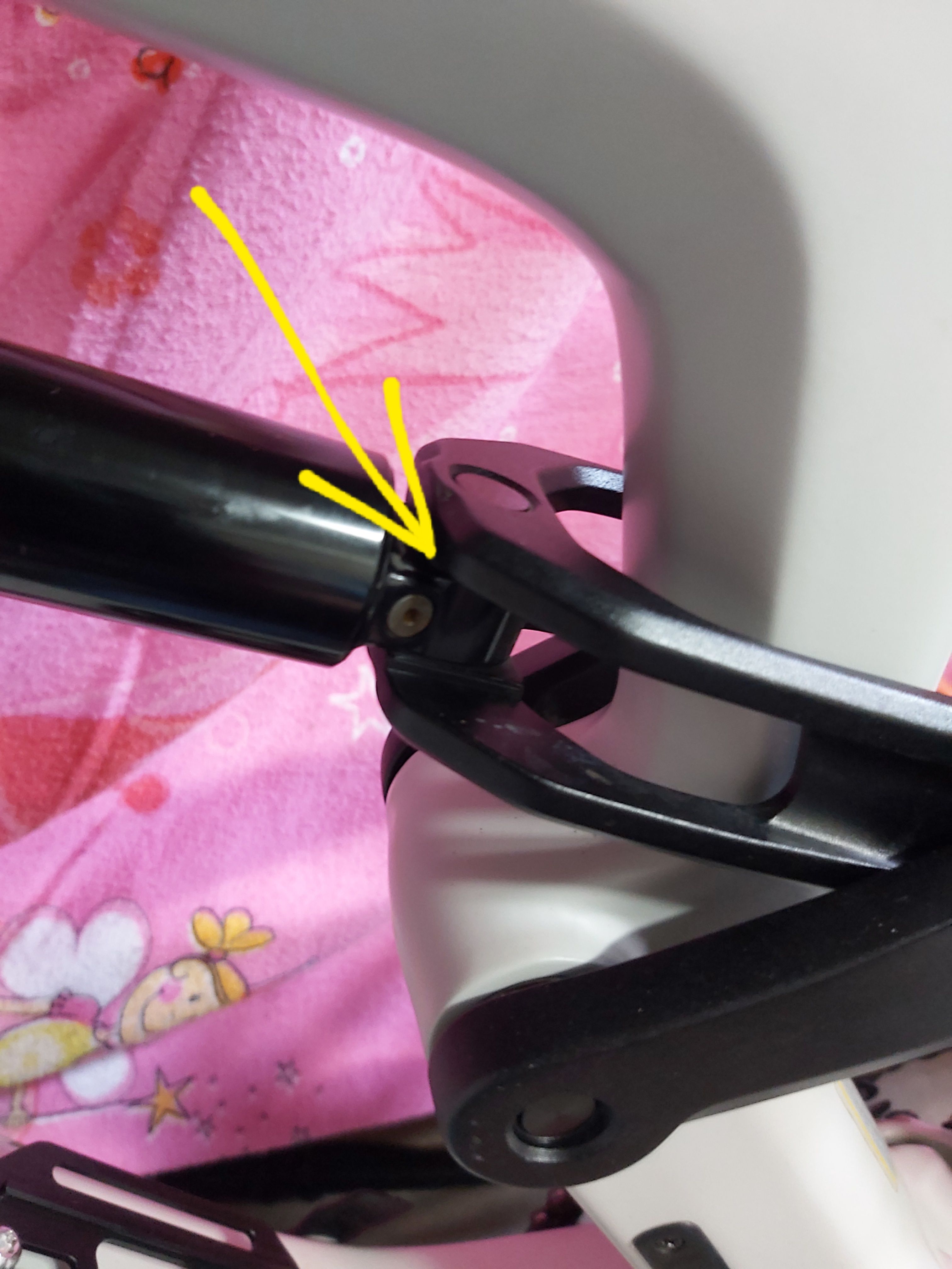

After my ride today I noticed a little play between the bottom of the shock & the bolt of the shock mount. The bolt is thight. Could it be the mounting hardware?
You notice the play when you lift the bike a little at the saddle.
Problem solved. Removed the bolt completely & put it back on again at the torque setting and the play was gone.
