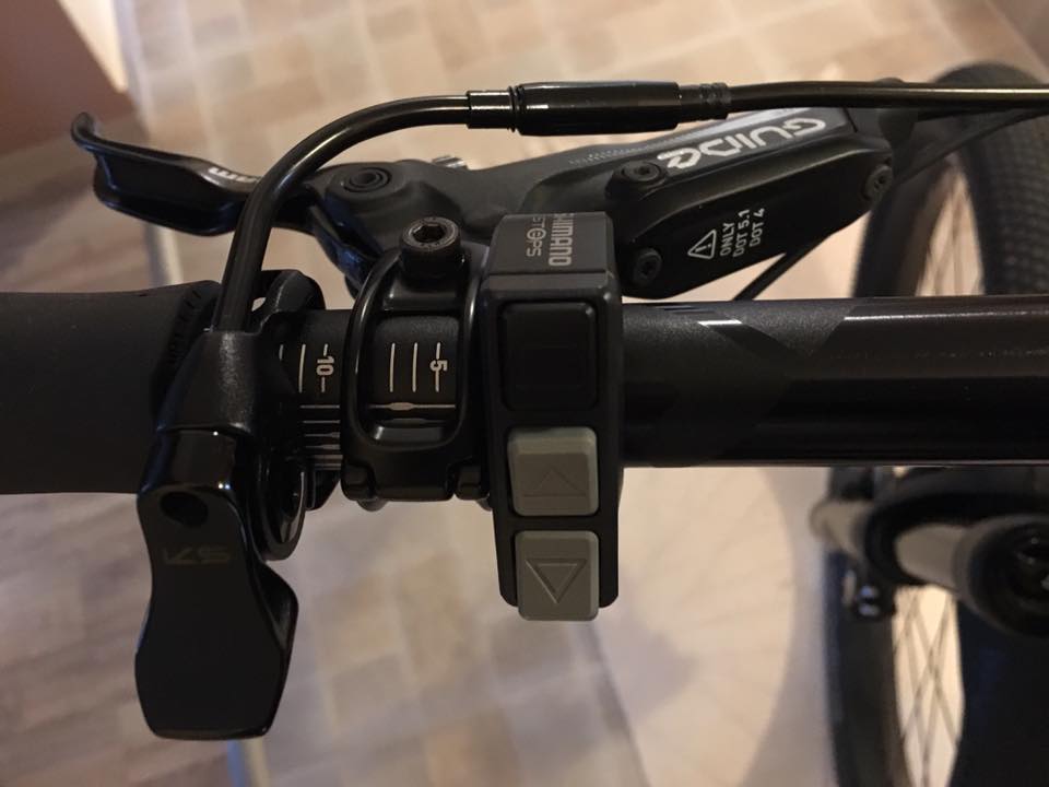

Also, I changed the assist switch lever to the E6000 button switch (luckily in real it is much smaller than you would think from the picture). For me it just makes more sense and I can install a BikeYoke Triggy remote for the dropper post.
